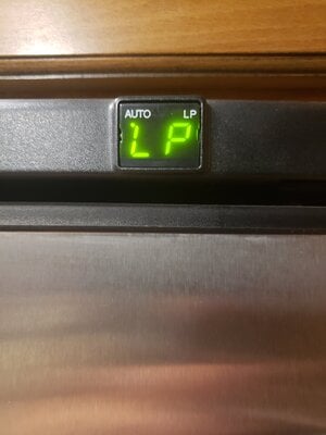

I notice my refrigerator is blinking LP but still the small red light above Auto is still on. Anyone know whats going on with my frig.

Could be it doesn't have a 120v source and is searching for gas, you're out of gas, the gas supply is off, or it's not lighting.

No my batteries showing 14.3. We have propane going through on the stove so I assume propane is getting through.
