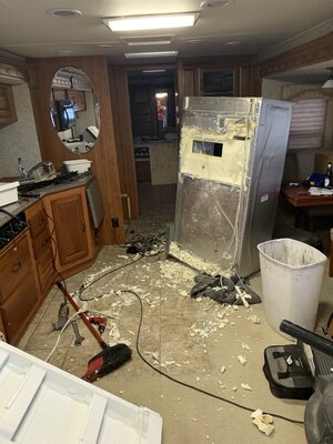

Our Dometic fridge went out so I replaced with a resi fridge. While not difficult can be a bit of a challenge Here is a photo of old fridge once I had it removed and the new one installed. I am not sure how yours is installed but this was not just a simple slide it out event. that is probably why the past owner "engineered" a fix. Good Luck! Post updates.
