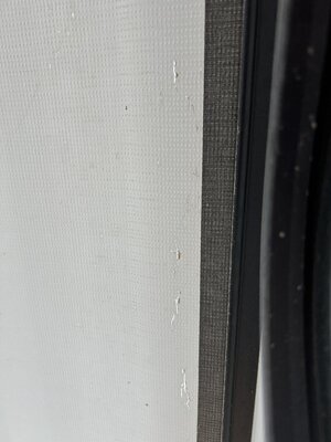

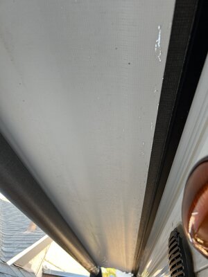

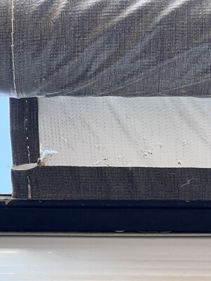

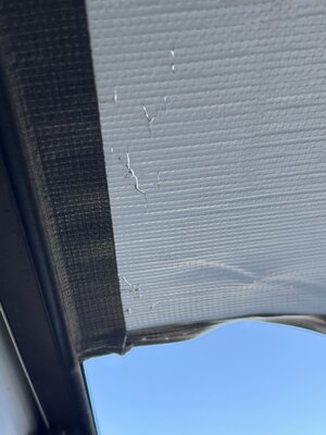

Hello,
Curious if there’s a good way to extend the life of our awning fabric itself to prevent tiny cracks from getting bigger or tearing completely.
Flex seal tape? Duct tape? Something else? Nothing?
We live in the flaming hot, dry desert with a UV index of 12 right now roasting and ruining everything in sight and we are just noticing that we’ve got tiny cracks in the fabric from sitting under the blazing hot sun. They are only near the top where the sun hits all day while it’s retracted.
Replacing the whole thing is not an option right now so I am just curious what the best product to use for patching the cracks is?

Fiberglass or reinforced awning/tent/sail repair tape. Make sure the surface is clean and dry. Amazon has it. 3.5" -5" widths . it's very sticky so take your time. It's not permanent, it will last a year or so exposed to the elements
