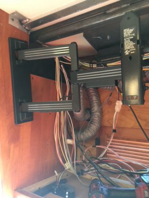

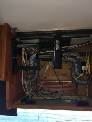

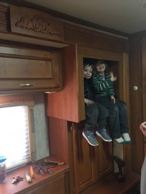

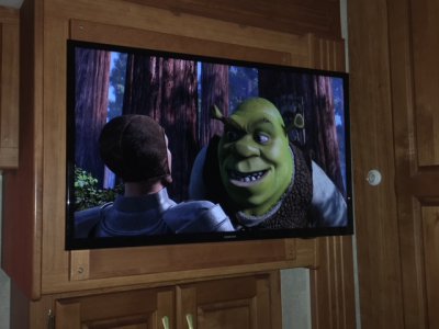

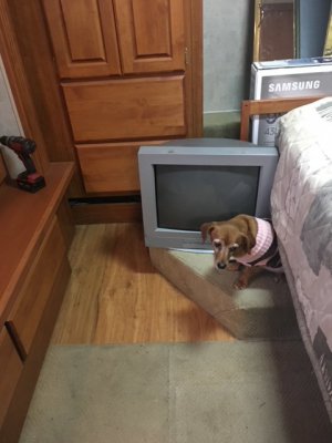

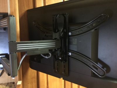

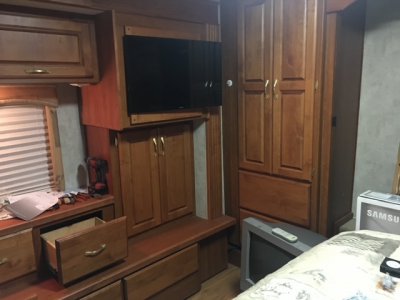

I replaced all of our 80 pound TV's with modern flat screen smart TV's. It was EZ. The 2 biggest problems you'll run into is the old TV's were relatively square. The new flat screen TV's are rectangle shaped. If you are creative you won't have to rebuild all of your cabinets and it'll look good. The second problem you'll run into is how to keep the TV from swinging out on it's articulating mount every time you hit a bump in the road. The mistake I made was buying swing out TV mounts from Costco. They worked VERY well and were very sturdy except there was no way to lock them into place for travelling down the road. So the TV's would swing out every time we would hit a bump. Classis Coach Works installed swing out TV mounts that have locks on them with a cord that hangs down so you can pull the cord and unlock it so you can swing the TV out to access the cabinet behind it or to give you a better viewing angle. Here are some pics from the bedroom.

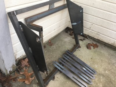

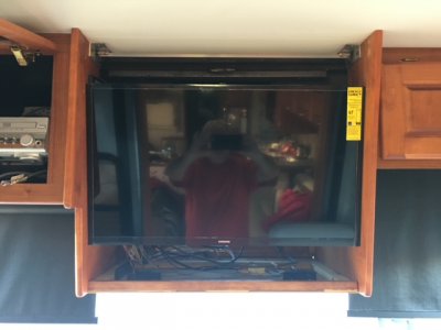

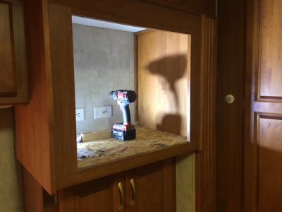

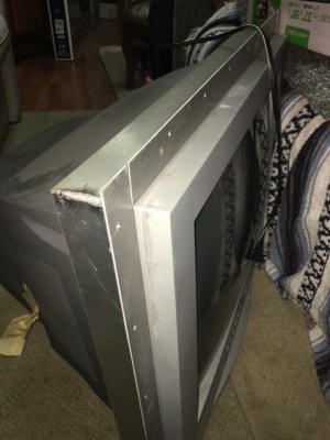

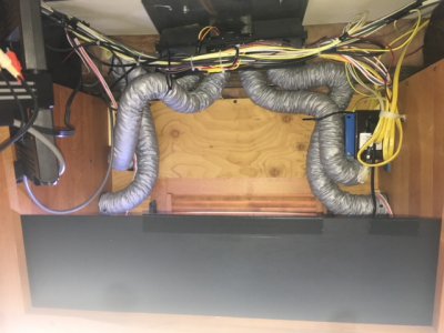

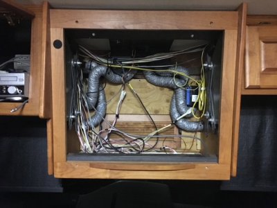

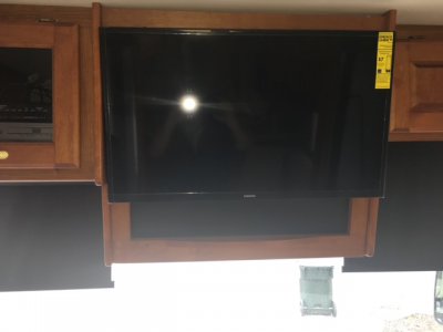

Here are some pics from the living room at the front of the coach. Notice how unruly and messy all the wires and cables and H&A hoses were from the factory. I tied up everything so it is very neat now. Notice how the old TV was square and the new 36" flat screen is rectangle. SO I made a panel at the bottom of the opening and painted it flat black. It fills in the gap at the bottom of the TV. You hardly notice it at all. Now we also have a nice deep cabinet to use for storage of DVD's or CD's or cellular routers or whatever as well. Also note the 50 pounds of square steel tube roll cage that was around the original TV. Between the weight of all that steel and the weight of that old TV, I bet I removed close to 100 pounds!! :ROFLMAO:
