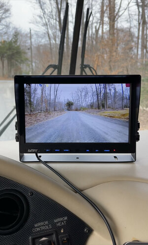

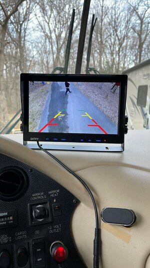

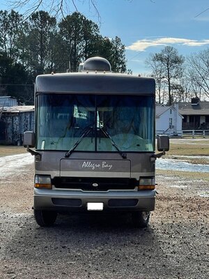

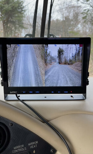

I put the license plate camera on the front of the vehicle and replaced the current backup camera at the back. I am planning to install one more license plate camera at the back. I am not sold on putting side cameras ( as I feel it will be too much of a distraction ). I will let you know in a few weeks how the System is working. So far I am impressed with the camera feedback even while on the road and the camera feeds are not shaky.

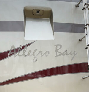

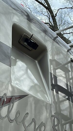

For the rear camera we removed the old camera and used the power wires to power the new camera. The old camera was only getting 9v, so we need to cut the wires at the monitor and ensure it is getting 12v as the wireless cameras require 12 volts. We also removed the old camera support holder, and cut and attached a small pvc board to the outer plate using 3M 5200. Then screwed the camera to the pvc board. If you zoom into pic two.jpg you will see that.

It took me and my friend 5 hours to replace the cameras ( we screwed up a couple of times and had to redo it ) but overall pleased with the results. I use the cigarette adapter as a power source ( you can also hardwire the power source ) as I can activate it when I need it with the push of a button. In future I plan to hardwire it to the power of the old terminal.I put the license plate camera on the front of the vehicle and replaced the current backup camera at the back. I am planning to install one more license plate camera at the back. I am not sold on putting side cameras ( as I feel it will be too much of a distraction ). I will let you know in a few weeks how the System is working. So far I am impressed with the camera feedback even while on the road and the camera feeds are not shaky.
