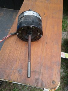

It's a RVP 8000. 4 years ago it stopped working while we were traveling. Dropped the inside cover and gave the motor shaft a spin. It started working. WD 40 kept it working until we got home. I replaced the motor and it's worked untill now. It works on low cool. High cool it throws the breaker. I can feel it vibrating. I'll replace the motor again. Gotta think it happens on this model frequently, because the motor is available all over the internet for less than $100.00. I'll let you know how it turns out.
Motor replacement took about 2 hours. I'm not an engineer, but that's a long shaft without reinforcement. motor.jpg
