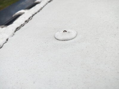

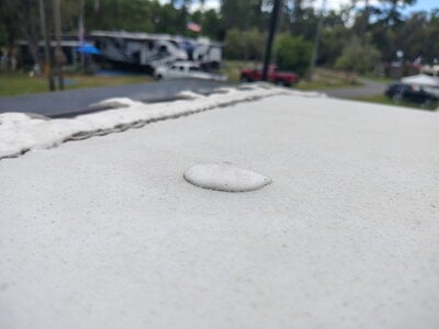

I have a 2022 280RK that I just had it cleaned. The person that cleaned the food noticed 3 staples coming out of the roof in 3 different spots. I then called the people that does my Rv repairs and advised me that there are more than 3 staples coming though. They told me that the roof needed to be redone. I called my insurance company they won’t pay because it’s a manufactured defect. Then I reached out to crossroads sent them pictures of the staples coming though and were someone tried to cover them up with sealant to cover there butts. I bought this camper because of the Warrenty and this is what I get!! A month out of Warrenty thank you CrossRoads “Keystone” for your help. They want to install a roof vent in good faith lol.

Remove the abomination, clean it up, slap some eternabond on it and carry on.
