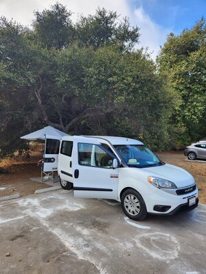

Hi, I'm converting a RAM Promaster City Van into a campervan. The first thing I need to have installed is a roof mounted vent fan. Because this is a minivan, I think an 11" X 11" would be sufficient. After making lots of calls and research to van conversion businesses, I had sticker shock with quotes of $800 to have this done! I'm in L.A. and live on my service-connected veteran pension. If anyone can possibly direct me to where I can have this professionally done I would be very grateful. Do only van conversion companies do this? Thank you for any feedback!

Sticker shock is not all that unusual these days for any vehicle repair/modification. Sadly, the quote doesn't sound all that unreasonable once you look at the break down (if the procedure is supply, install from start to finis). Labor rates in excess of $200.00 hour are normal. The actual cost of the fan itself will be over $200.00. So cutting a hole in the roof. Reinforcing the opening, running 12 power to the fan in about 2 to 3 hours is not excessive.

The installation is not difficult if you are not only handy but quality conscious and do it properly. Make accurate and precise cuts. Make sure you add reinforcing to the opening and use good insulated wiring. Use butyl tape between the fan and the roof and then use Dicor to seal around the frame exterior. Many of these vehicles actually have a spot on the roof that is flat for this exact reason
