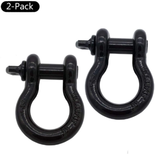

For heavy duty connections such as I used when towing a boat people use "d ring shackles" they appear to be called.

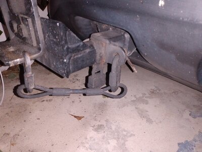

My safety cables attach to RV and run to tow bar holders attached to car. See pics.
Based on what I see here--I would be very nervous about it actually working.
To clarify -- you only know that the setup is safe with it pulling the load that it is protecting.
I think the rust alone (if what I am seeing is rust) indicates that the material won't live up to its original design. Then knowing what rating was on the quick connects is another issue.

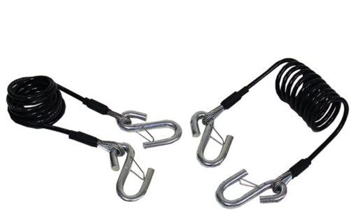

Roadmaster literally puts these on their 8k# & 10k# safety cables, the latter of which are included with their Nighthawk towbar.
I’ve got no issues using the ones that came with my safety cables from Roadmaster.

I had the same problem with the hooks when I went with the heavier cables like ARD has. I removed the spring closers from the hooks as my last set never had any, and the hooks fit easily. The cable being coiled, will/has held them in position just fine for the last 20k or so.
