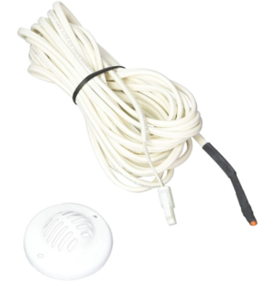

Actually 2 questions. We have just acquired a new to us 2004 Newmar Mountain Aire Class A (workhorse & 8.1). In going through the HVAC system (front and rear Penquin heat pumps) I have a couple of questions... first the easy one- Where is the Zone 1 remote t-stat located? The CCC is in the control cabinet above the door but I have to believe there is a remote sensor somewhere however I cant find it. The Zone 2 remote is mounted on the interior bedroom wall, passenger side but no sign of one for zone 1 anywhere.

Welcome @nowherejoe. There should be a small black "thermistor" they are called which are the sensors the T-STAT is using for the two zones. I don't know in your specific coach but mine is outside of the half bath on the interior wall and the other is in the bedroom. Newmar has been moving these around trying to find the best spot. Hope you can spot the black plastic device attached to a wall or cabinet.

1624415120335.pngThanks Neal for the quick response. My sensors (at least in the bedroom) are white and as I said in the OP, I located the one in the bedroom for zone 2. I was hoping someone with a MA 3778 of similar vintage may be able to let me know where their sensor for the front (zone 1) is located.

My sensor location has been solved. Seems Newmar hid the zone 1 temp sensor under the dry bar cabinet lip...it is on an inside wall. thanks for the feedback.
