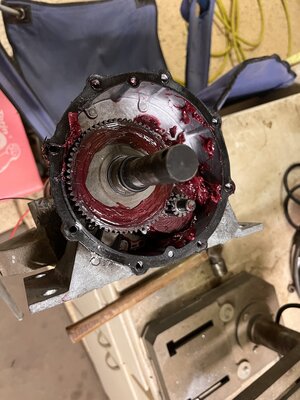

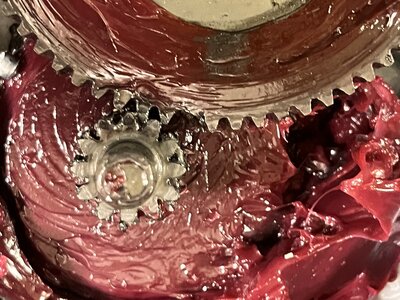

Mine was a single tooth broken off one of the reduction gears and it was $800 for a new unit. They don’t sell the gear box, much less individual gears. I read about one case where the owner had a machinist friend who made a gear for him, but he only made one. I kept the old unit for parts but its a shame that something so minor requires an entire motor/drive assembly.

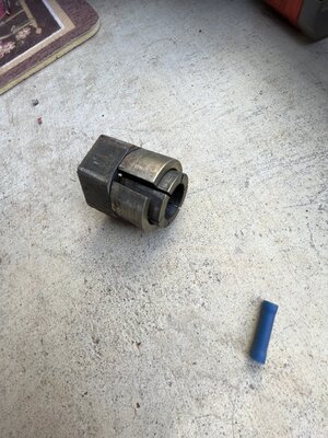

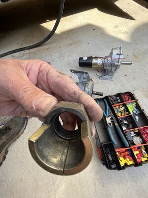

Nice catch on yours. Trans torque bushings can just loosen up sometimes and just need to be tightened up. I’d recommend loosening yours and inspecting the internals - might be able to re-install it rather than replace it.
My broken gear:
In case you haven’t had a TT bushing apart (you probably have):
