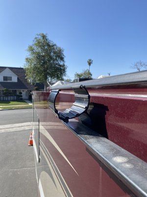

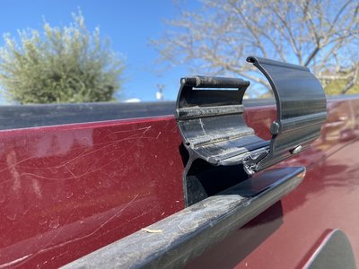

Does anyone have these type supports on there slide topper an a 2019 Coachman Mirada 32ss? See the pictures below

Have you had any problems with wind. Mine popped out of those supports and ended up on my roof. Fortunately it the fabric part didn’t get ripped off the roof. It that would have happened the roller would have launched on the highway and could have hit a car. Mine popped out of those supports several times but I was able to pop it back in. Once it pops out it then it is easy to pop in and out. Which is dangeres. Keep an eye on those. They don’t use those anymore the have what the call a cradle which has a piece that goes over the top.
