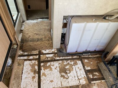

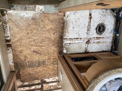

My Rv had soft floors when I bought it. When I removed the final and got to the sub floor they used strand plywood. Not very strong. Also the supports were greater then 2 ft apart using the foam as support. After heavy use the foam collapses allowing the plywood to give. I replaces the strand board with high quality plywood and that fixed the problem.
