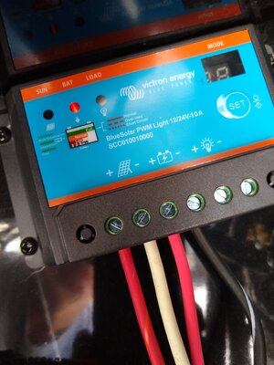

I bought a 2021 Coachmen Sportscoach. I believe Jaboni set up the solar system (100W s. panel on the roof and charge controller in the basement near the batteries). Question: Why isn't the solar panel registering on the charge controller? I took the two + - leads off the controller and receive 19.2 V on my multimeter. Yet when connected, it doesn't show the solar and thus not charging the house batteries.

Rick, I tried your suggestion of using a known good battery. The CC still did not recognize the solar panel. I tested the -+ leads coming from the panel and it registered 19.2V. Just for giggles, I switched out the CC that came with the motorhome with two others. One of which was for my starter batteries - that I witnessed working perfectly. So what do the 3 CCs have in common? They are PWMs. So I broke down and bought a MPPT on on Amazon and will try that. If it doesn't work, I'm out of ideas. And thanks HH for your suggestion.
