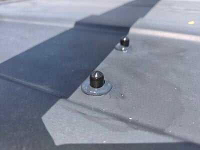

Jeep Mounting. I'm first going to test out inside Mounting. It will be screwed into our Freedom top...and I'm running a short aftermarket cord from the headliner down to the center console.

I found out...the JKU top is just a thin molded material...so the rivnuts I used show thru. Evidently, the JL's are rumored to have some insulation sandwiched in the newer Freedom Tops...so you don't penetrate the exterior layer. Not a big deal...can't see if anyway with the Gobi Rack up there.

The mount, is simply a piece of Aluminum from Home Depot. I copied the design on paper (two sheets) and taped them together. Fold the paper and lay on the SL Mini to check the fit. Then transfer the lines to Aluminum, cut, and bend. Drill mounting holes as you like...
Not a fancy piece of kit...but gets the job done, I used knob screws so, I can take it down quickly by hand if we want to deploy it somewhere else, for better signal...or close to an activity where we can't drive the Jeep.
I did put a bit of 1/8" Neoprene tape sandwiched between the SL and the roof, to give it an air gap and quiet down any rattling... might have to fiddle with that as time goes.
