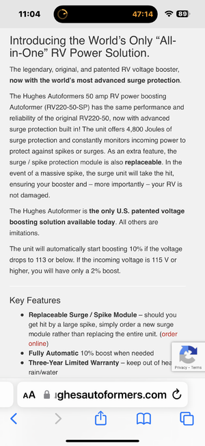

From what I’ve read, low voltage is a much more real possibility and more common problem. The Hughes Autoformer is one solution to the problem, but a fairly expensive one. Cheaper than replacing expensive electronics though. The Precision Circuits Power Control System in my coach has inverter assist, so this should not be an issue, although I should probably confirm it is actually communicating with the inverter.
