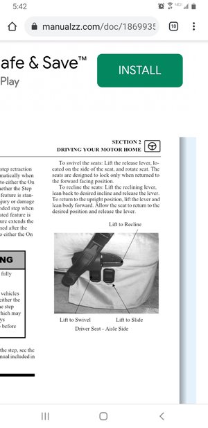

Its a 2004 winnebago brave. Can't find brand of seat but here is pic
I didn’t catch that last part of your sentence where you said the lever wasn’t working.
When mine are locked into driving position, they can wiggle left to right slightly. If it’s not straight when I go to pull the lever and release them to swivel them around, they don’t release. So maybe give them a wiggle while pulling the lever.
also, do you feel any resistance on that level when you pull on it? If not it may very well be broken.
maybe also try pushing the lever in
Look under to see if the cable is attached to the spring lever on seat base. That would have been the first thing to look at
Mine swivel but you really have to push to get them turned around. I know my lever is unlocking but I think the grease is old and needs to be replaced.
The grease is not old. Someone tightened the 15/16 nut in the middle of base too tight. Loosen it a 1/4 turn
