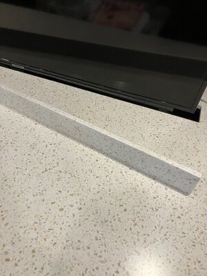

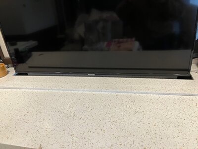

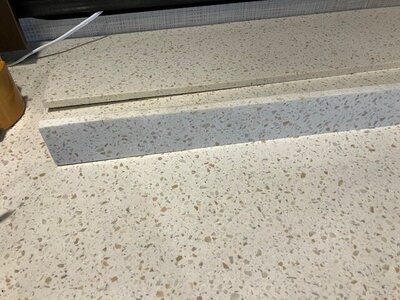

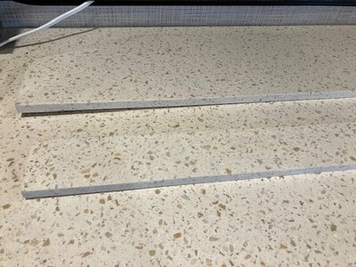

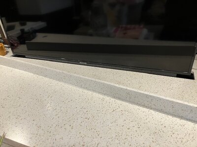

I have 2021 Ventana and I have a piece of trim that fell down under my televator. I thought I was having problems with the televator so I opeaned the cupboards under the TV and found a long piece of Corane trim about 1/2" thick and about 4" wide. I can't figure out where it came from. Newmar doesn't seem to know either. I will attach some photos of it.

There's a piece of corian that's on top of televator. That makes countertop when TV down. Another piece of crian that is attached to the televator at the bottom of tv to fill the gap when tv is in usable position. Bottom corian is held with 2 screw into the corian. If stripped out corian is tuff to make new threads. I used a tap and made hole a little longer.
This is what I was thinking. However, mine was glued on. So is yours screwed to the counter top?
It is screwed to the televator to raise when televator goes up.
