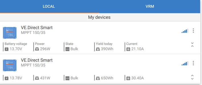

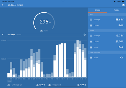

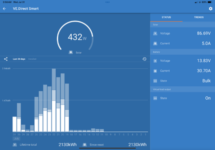

I check by looking at the output from my controllers (each has its own blue tooth gizmo) and I can tell by the output if all is well: IMG_3596.jpegIMG_3598.pngIMG_3597.pngl
Each panel should put out around 29v and 10a. I don’t go by wattage because they never get close enough to their rated 315w for the math to be conclusive. Five panels - 2 on one controller, three on the other. So I would know if a panel wasn’t doing its job, but these are LG panels, around 5 years old, and very unlikely to fail. Of course mine is a very simple system - really just a big battery charger tending to a bunch of aging LA batteries.
