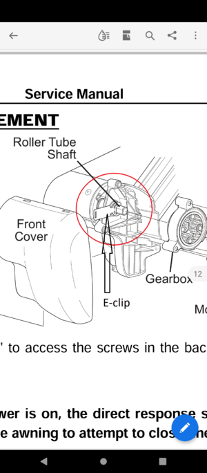

I’m posting this because we have had endless quality problems with our brand-new 2022 Omni, many of them just bad workmanship, but some of them serious. This one could have been fatal if the awning had deployed while we were driving. I’ve attached the image from the Latitude awing service manual and circled the E-clip in red. If you’re concerned about whether your awning has the E-clip in place, you should be able to easily remove the black plastic motor cover using a screwdriver and visually inspect the exposed shaft. Or you can have your dealer or service center do it next time you have your RV serviced.

I don't know what awning is on your Chateau, but you should be able to tell the manufacturer and model by running your awning all the way out and looking for the model information on a sticker on the interior of the awning. The sticker on our awning is on the right interior side of the awning on the roller shaft. You can find the user manuals for Carefree awning on their website at: https://www.carefreeofcolorado.com/
