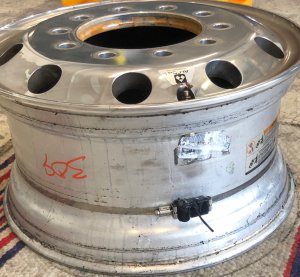

My 2020 Canyon Star has 255/80R 22.5G Michelin tires. The coach has been corner weighed and has 3910# on Left Front, & 3725# on Right Front.
The Michelin tire chart shows a capacity of 4300# at 80 PSI. So each tire is under that capacity. This leads to my question.
Would you be comfortable running 80 PSI in the front tires? At 80 PSI, I will be 390# under on the left front, & 575# under on the right front.
I had been running 88 PSI in the front, and rear.
I feel that the lower pressure should enhance the ride quality.
By the Michelin tire chart, I can run 85 PSI in the rear, and have about a 500# capacity cushion. And the 3PSI less per tire, should help the rear ride quality too.
What say you?
Thanks!
