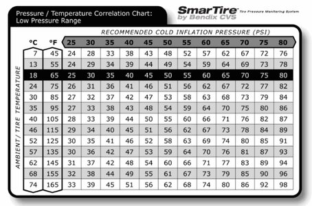

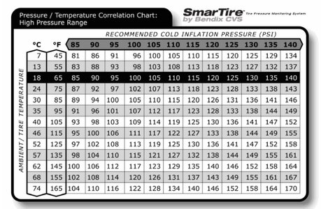

Over time we have seen multiple discussions about tires, pressure and temps.
Haven’t posted these in the past but thought these would be useful here as a reference. “Cold temp” pressure readings are designed to be at 65F. When it isn’t that cool (or warm) this helps me understand how much variance I can expect to see. This also helps explain why TPMS systems don’t complain when the tire temp climbs 10F, if there is a corresponding temperature change.
For instance, our front steer tires have a cold pressure of 130 psi (at 65F) but when they reach 125F on a warm day driving in the sun, that tire pressure is expected to be 147psi, a 17 psi increase. So I know not to panic.
These tables are from Bendix:

So this information is where they were able to calculate the table
Everything that I've read indicates that "cold tire pressure" is the pressure when the tire is cold. Meaning it hasn't been driven for at least 3 hours and the sun isn't beating down on it, typically increasing the temperature and pressure on that one side of the coach. My steer tires should be 110 psi cold and all the others are at 85 psi. As I'm prepping to depart, my desire is for my tire pressure to be the pressure I indicated. I do not believe I want to start off with my tire pressure higher just because it 30 degrees warm outside. I want my cold (say 95°F) steer tire pressure to be 110, not 117. If I have this wrong, please point me to a credible source for this info. Thanks
This " pigheaded Dutch selfdeclared tyrepressure specialist " also is in the smaller camp that states you have to calculate the tyrepressure back to an index temperature ( as Rimex calls it) .
