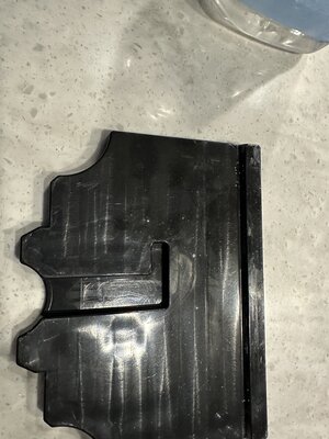

We have been fighting with this lock plastic for awhile.
It refuses to lock at all. It appears that unless you get the freezer in just the right spot it’s a no go.
Considering increasing the radius some with a file to increase the window of acceptance.

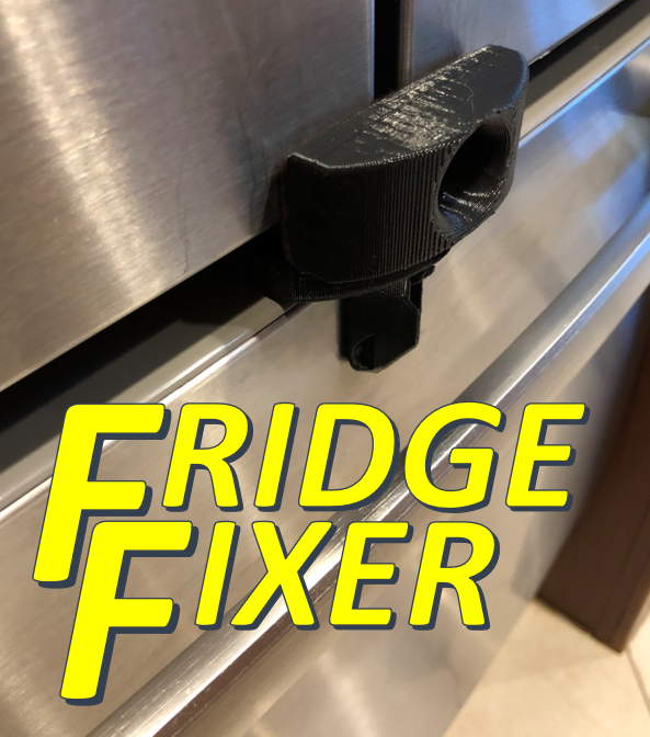

You might try this:
You might try this:

A small amount of dry lube seem to make it doable. Also just hit the edges to trim off any high spots/ flashing. Determined it is the freezer that needs to be pressed hard.
But now it works.
