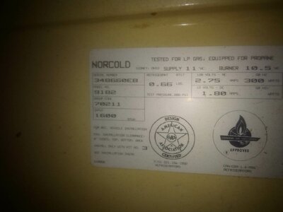

Take a picture of the label inside the fridge with numbers on it and send it to me. I have access to parts finders.
Ok I'm attaching a picture of the label, sorry for the picture quality I tried to get better but it's a mediocre phone camera. Thanks

Thanks for that, even with that info I cannot find a part for you. I am not sure what is the problem but I will continue to look for it...
