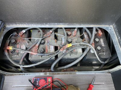

Have a 2021 Vacationer 35K, considering upgrading the battery. Current 12v setup is 4 x 6v 225ah FLA in Series and Parallel. 1 270ah Li battery is what I’m thinking.
Does the converter / charger in your RV have a battery recharge setting for a lithium battery? This matters to prevent inadvertently over charging or under charging the lithium battery - either will cause damage to the life of the battery.
