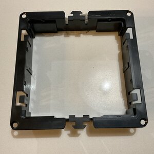

Interesting if you have a KIB light panel it should not have been glued in place. The wall gets cut to fit a black plastic plate held in with screws to the wall board that is open in the center, the KIB switch plate snaps in to that . To remove it is tricky and requires a slim hock tool to put between the KIB Switch and that black backing plate to release clips.
Here is a picture of the black plate, they come in double and single wide, this is double
