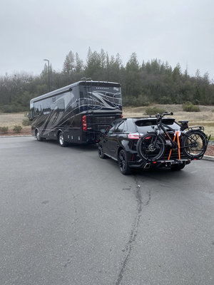

Hello, my name is Darwin Neal. Today I asked myself a question I often wondered if I'd ever ask myself: "Where did my bike go?"
Today I left Vegas northbound for an absolutely spectacular drive. On I-15N taking in the amazing views of snowcovered mountains and driving through old stomping grounds I used to fly A-10's when I was stationed at Nellis AFB. Knowing I was heading for snow country I put the bike cover on my rack which I've used many times. I've often wondered if it was acceptable as it sure had to resist a lot of wind force but I have a hefty bike rack (Kuat NV 2.0) after selling my much more flimsy Yakima rack. My yakima rack had one of the plastic holder at the top shear so I was done with that early on, very very impressed with the Kuat and even after this story that sentiment remains because I am a dumbass.
Very fortunate my Ventana has a rear looking camera to help monitor the toad and traffic coming up from behind. I had just done a crosscheck paying careful note to the bike as on my way to southern TX I had another bike incident where the rear wheel detached from the frame (clamp came loose) and the bike was leaning aft 30-45 degrees. Moments later after verifying all was good with my bike I asked that bone chilling question "where did my bike go". I noticed people were avoiding me like the plague but no one signaled me of an issue, I'm sure it had just happened.
I immediately pulled over to find the bike barely hanging on connected by the plastic strap that secures the rear wheel. The front bar (u-hook) sheared off at the connection. Had this bike separated it could have killed someone. IT COULD HAVE KILLED SOMEONE! My life would have changed forever having to deal with that as well as whomever I caused harm to in the process.
I secured the bike to the inner mount and drove on. Shook up and was stunned for quite a bit of time from this situation. I am sharing my story as I've done with every other one so YOU CAN LEARN FROM THIS TOO as I know others use bike covers on their bikes too and you CANNOT!
Before I went off attacking Kuat I did a search of their web site. It is there, as included below, that NO, you cannot use a bike cover for this very reason. Maybe someone with a brain would have checked this prior to using a cover???
The bike sustained minor damage as I believe I caught this soon. I will need to replace the handlebar and one brake. Sadly I need this bike for an upcoming campground as I won't be near places I frequent but I think I can ride it. Fortunately plenty of bike places in AZ so I'll try to get it repaired or see if I can get the parts myself.
One other note: As my bike is not of great value (around $800 + accessories) and as I often remove it from the rack at the campground I rarely secure it with the built in lock cable. This lock cable can save a life. It would have prevented the bike from separating from the toad as the only thing holding this in place was a plastic ratchet strap down. I will now ALWAYS use the bike lock cable integrated into the bike rack.
Before I leave you with this here is a secondary question that I don't know the answer to. Which insurance IF ANY would cover this situation if property or life were affected by the bike? The toad is being towed so I don't know that the toad insurance would cover this situation. As this is not part of the RV I'm not sure the RV insurance would cover this? This is an interesting situation that would be even more legal fees trying to figure out who is responsible to cover the damage.
Please learn from this terrible day that ended up with no one hurt by the grace of God. I'm still razzled just thinking about this.

Thanks Neal for posting this warning! I am taking delivery of the same Kuat NV 2.0 bike rack next week. Since this is the first time for me to haul bikes behind the toad I have been wondering about a cover for the bikes too. I had not considered, or even thought about, the added stress applied to the bike rack by the wind resistance created by the cover. Thanks for biting the bullet and posting this warning as it definitely prevented me from making the same mistake! You get big kudos from me and I'm sure many others who will ultimately benefit from your honest display of a mistake. What a great use of the forum!

Thanks for the reminders Neal! I just got my new e-bike and a new rack (1up). I made sure it was rated for being behind a motorhome and so far have not had any issues. 1up states can't be used with bikes that have fenders but as long as they are not overly long fenders, it's fine. They have the bars that push up against the tires (the main "holders"), a velcro strap for each tire and a locking bar that goes through a tire and locks to the rack on the other side. Besides their supplied items, I also use a ratchet strap to secure the bike to the rack. I don't use my cover when transporting because it blocks my cars brake lights and also the license plate.
A side note, while in the campground I secure the bike with several cables (need to get the stronger [expensive] bike chains that can't be easily cut). I also have two movement alarms on the bike I activate. As for the cables, they easily go up around the front slide-out arms and I also found I can put a cable through the front tire rim.
