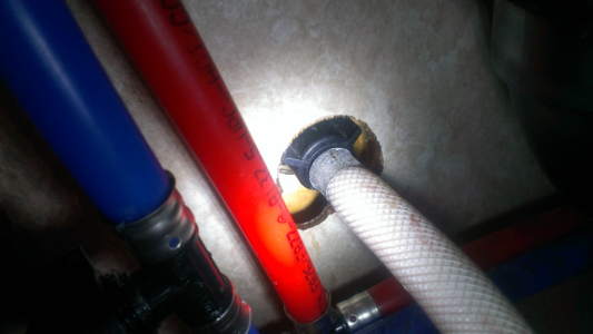

My washer line is leaking this yellow stuff
and a trickle of water. Can someone tell me what this is? I don’t have a washer hooked up.

Looks to be something similar to algae. Have you disconnected the hose to flush it out and checked for a screen on the inlet of the washer?

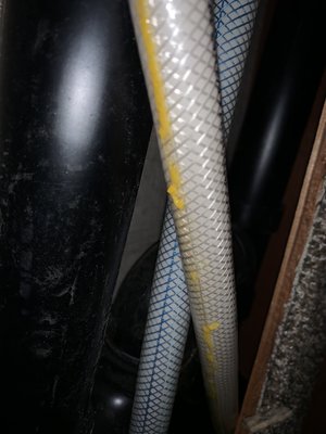

Either you shut the water off to the whole trailer, or where the hose hooks up to the trailer (opposite end from the washer) there is a shut off valve. It should look something like this:

That’s what I thought. The leak is below the red shutoff valve on the actual line so I guess I need to shut off all the water and change that line out. Thanks!!!
That connection should be a crimp type of connector something like this:
