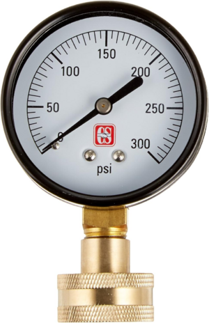

Simple way to test pressure at spigot
That gauge is the one I have.

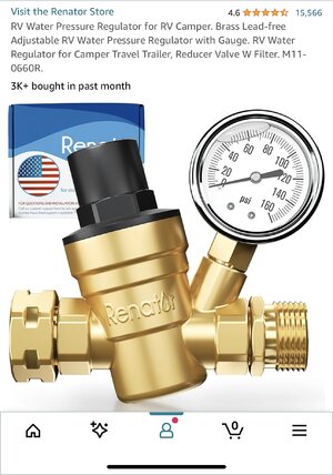

Don't understand the why behind it but the adjustable kind is supposed to have better flow rate than the nonadjustable, preset pressure ones. I have had both and agree it seems to have better flow.
