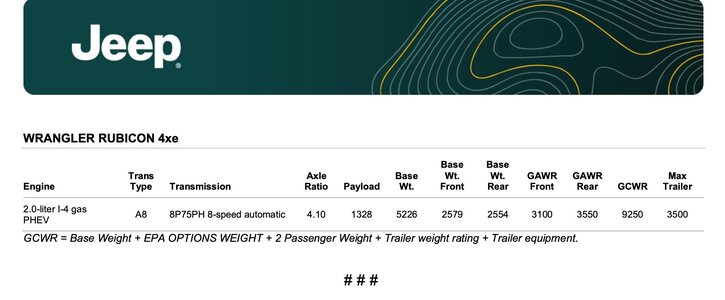

What is the tow vehicle and what is the payload?
There is no payload, The tow vehicle is literally empty other than a full tank of gas (it was full in both measurements above). There were no occupants in the vehicle at the time I weighed it.
That is what you are missing. What is your vehicle rated to haul? Not tow. You as a passenger are part of the payload.
I'm not sure what difference that makes. it is rated to haul 5000 lbs with a 500 lbs tongue weight. Now that this is known, I still can't compute the actual tongue weight.
My Ram 3500 is not rated to haul 5000 lbs. What is your vehicle?
Take it to the scales and you’ll know for sure. Vehicle on the scale, trailer off, and weigh the vehicle with the trailer connected and disconnected. That will tell you the actual (real) tongue weight.
Yes!! You have calculated right!!! Why the trailer you rented has a 30% tongue weight is beyond me!!!
The weight is the weight with or without a driver. The information you gave is overkill, so this can lead to over analyzing things.
If I built a trailer that only had the proper tongue weight when loaded, I would get out of the business of building trailers. "Return it!!!".
Good lord Kevin, you went straight to the excessive tongue weight. But you have no idea what he is hitching it to. And he won't say. And he does not realize what payload and towing capacity are. I was trying to gently educate once I had enough info. I could care less what his front axle and rear axle are unless I know his wheelbase and ability to carry a load. But in the end the advice is correct, return the trailer or buy something that will tow it.
