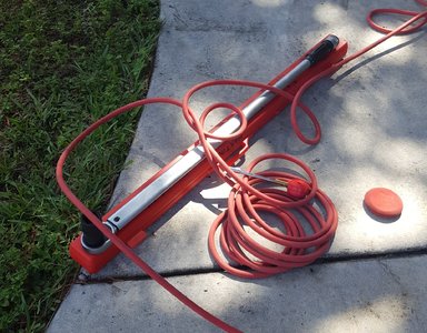

I had to order one that was bigger. My largest was 300 ft-lbs... Now, 600 ft-lbs...
Our 22.5" wheels...if you remove the plastic nut covers...the torque is written on the nuts in raised letters. At least on our coach. Torque is 450 +/- 25 ft-lbs... I would look for guidance specific to you coaches chassis builder.
