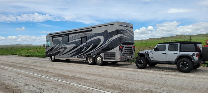

We have been traveling for the past 2 days, and every stop I have done a visual inspection of the towbar, and tow attachment plates as well as a normal walk around.

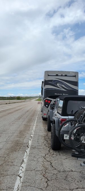

Our last stop was at a truck pull out. We had just finished 6 hours of driving in a steady rain, so I wanted to see if the electrical connections where still good.
As I was walking by, I noticed this on the tow attachment plate.
You will see that 2 of the nuts are no longer lined up. These are not structural, but they do keep the bumper attached to the frame, and so they are very important.
I was able to notice this in the 2 seconds I was walking around. It took longer to get the socket and ratchet out to fix. Once we arrive at our destination I am going to get the loctite unpacked...must have forgotten to use it on these.
