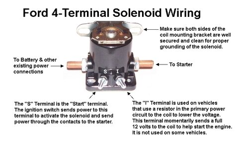

I still have spares that I’ll never use, but I used to harvest those, relays, bulbs, and fuses from Pick and Pull. So I have quite a few.I used to fight with those solenoids constantly on old vehicles, and the wire on starter also.
I will check those but. Switch has no 12 volt coming to itI still have spares that I’ll never use, but I used to harvest those, relays, bulbs, and fuses from Pick and Pull. So I have quite a few.
