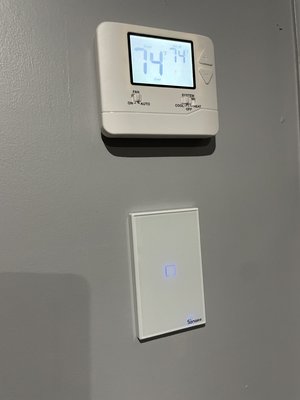

How’s it going! I installed in my rig sonoff smart switches from Amazon. They were originally 110V but I made them 12V with a couple modifications and they work great. My rig is completely smart.
