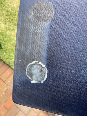

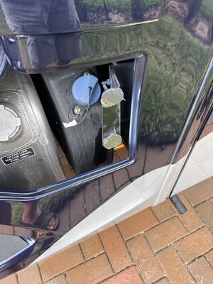

Posted a longer thread as to why but the epoxy on the SuperStar fuel doors can fail (both portions on our 22 have while parked) and the door can come completely off without unlocking.
Would be a nice upgrade to have flush head through bolts for the door connection to the hinge and painted to match.
Would be a much better connection overall and not prone to failure as easily.
