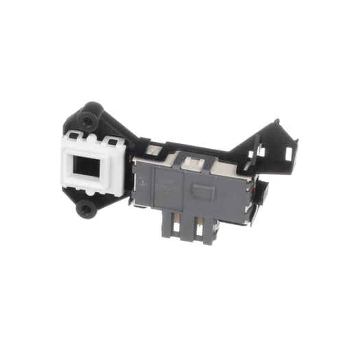

Ever since posting this my Washer has been extremely temperamental. What I have to do now is press and hold START and then open/close the door firmly. This tells me the door switch is on its way out again, already replaced once. I think this is something I can replace per YouTube a few months ago. I found a good supply source for the WFC7500VW2 washer. eBay seems like its good for parts too but I wanted to share this link:

@Neal What were the symptoms that led to replacing the door switch? My unit is intermittently not going into the high speed spin. Still troubleshooting but a faulty door latch is apparently one of the potential issues. Was the part you replaced the switch or latch? I believe the latch also has some (switch) contacts. Anyone else experienced & solved the no high speed spin issue with a Whirlpool WFC7500VW2 washer?
I personally think the door switch is whether the cycle will even start or not as it's detecting the door lock. If you're not going into high speed spin my guess is there is an imbalance in the load of laundry within. Open the door and redistribute the clothes and also grab the drum and move it around so it finds a new balance then retry the load of laundry. It may also be too much clothes for a small washer. Just my guess.
@Neal Thanks for the reply. Once I read the entire thread I saw where @FL-JOE seems to have had the no fast spin issue resolved by moving away from using PODS. We will give that a try also.
