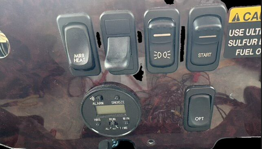

Guys - recently chased the above. Nice motorhome with freightliner M2 106 chassis and Mercedes MBE 900 diesel. The dash panel has an option rocker switch (see pic) that I do not know what it was for. I realize this is probably an optional or customized function for the MH. Prior owner did not know what it was for.
Just thought I would take the chance and see if others with this style motorhome also had this "Option" rocker switch. It is not so easy to trouble shoot wiring on a freightliner as manuals are kept pretty tightly by the dealers and Dynaquest (Forest River) does not have any wiring diagram to offer in this age of motorhome.
I will and can figure it out by tracing wires back to the firewall bulkhead connectors or wherever they lead to perhaps since I have been able to find what the pinouts are for at the various plugins. I do know one radio wire for reverse signal comes from a wire on the back of this switch but hthere are numerous other wires on it. I also found out that Freightliner prints a unique number on every wire but sadly those are only available to Freightliner dealers as I understand it. That is unless someone happens to have a complete OEM manual to offer. Anyways - thanks for any feedback in advance.

Optional switches were left to offer body builders options (pun intended). In Dynamax coaches, if it still bears the OPT label, it wasn't used for anything. I have one in my 2013 Dynaquest 360XL.
Well its got wires connected to the back of it so I don't know for sure yet. Thanks for the feedback!
Looks like the high, medium, and low engine braking that was on our M2 106 Newmar.
Were two switches for engine brake on / off and the other for how much.

Well that's interesting because I'll have to check if it is a momentary type action (as the prior guy suggested) or it is a regular switch, in which case it could only have two functions (one position or the other) At least I think so. I'll get back with both of you tomorrow when I return home. I have the other engine brake on/off you mentioned. Thanks again!

I considered that possibility for mine. The manuals I have discuss the use/operation of the two-switch engine brake and the single-switch brake, but have some ambiguity that makes one wonder, but what was clear in my manuals was that the engine brake on/off would be labeled as such.
I went to the horse's mouth. Brian Clemens, motorized division manager for Dynamax, confirmed for me that if the switch still bears the OPT marking, it was not used by Dynamax for anything.
I suspect the wires connected to the switch go from it to the 12v fuse panel. A subsequent body builder would then wire what they wanted the switch to control to that same terminal.

Who would of been a subsequent body builder I wonder. I say this because I don't think this was modified in any way and is the original setup by Dynamax or Freightliner. I only say this though because wires connected to back of this switch are tan wires with printed numbers on them. I'll have to double check the printed number part, but they looked to be freightliner wiring. But regardless, I'll try to trace them back to the bulk head module (if that is where they go) and see what I can learn.
As mentioned prior, I think there was a purple wire though on the back the switch, that had a reverse signal wire from the radio spliced into it. Not sure if that is correct at the moment because my new radio, which has a reverse camera is of a different type than my original Kenwood radio / camera, and is not compatible with it. I don't see a setting in my new radio to change the camera type, so anyways still working on that issue. My dash has just the one engine brake switch and is labeled as such. Thanks again!

Well, if you got it from Brian then you have the info from the person that should know.
Dynamax is the body builder. The switch is a standard Freightliner piece. Dynamax had no function assigned to it, so they left the optional marking on it. Had the same chassis been used for an ambulance or a tow truck, for instance, that switch may well have been assigned to emergency lights or some such component. I think if you keep chasing it, you'll find it doesn't go anywhere or do anything.
