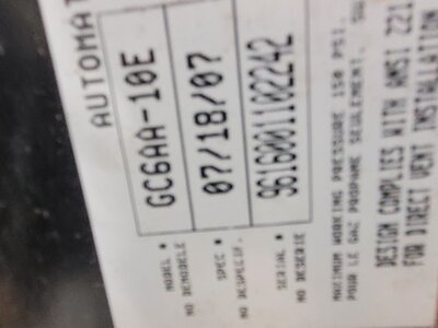

I found this on line. What type water heater do you have?
My water heater
