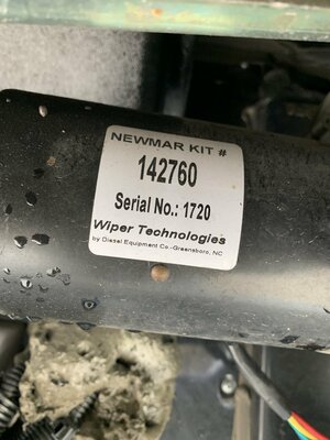

I would try integrityrvparts.com, I was able to get the wiper motor 60% less than Newmar wanted.
Did you have the part number or were they able to find it for you
I had the part number but I think they should be able to find it, they seem very helpful. I used Newmar part # for the kit (whole assembly) and got the part number for just the motor. I have a 2020 so May not be your kit number.
