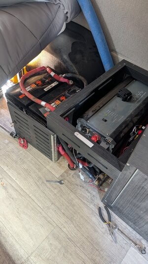

I would go this route vs the OEM KS2 batteries, they are garbage. I just did a conversion, but moved them inside. Accessing those boxes under the van is a pain.
640 AH for $1400. Plus prob removed 300 lbs worth of boxes, cable and the aux AGM.
Also added nice shunt for easy monitoring.
2021 Zion SRT.
