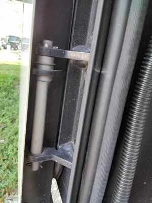

My passenger side front baggage door drops down about 3” when the door opens. Scared me to death thinking it was going to fall off completely. It appears the cotter pin on the hinge fell out and I’m trying to see what else would cause this. Has anyone with a newer model Newmar taken off their baggage doors to rehang? Guess I found my first project for the season. Any ideas or suggestions are greatly appreciate!

Without pictures, I'm giving it my best shot with the limited info. The cotter pin goes through the hindge pin to keep it in place.
Do you have the hindge pin?
This is the part that broke (item #6). I was able to order another from Newmar, now just have to take the time to figure out the proper way to remove the old and install. I will need to remove the door to rebuild. If anyones taken their baggage doors completely off and has tips that would be greatly appreciated . I will make sure to document the progress
Had that bushing break the retaining clip on the other side of the coach because of letting it drop too fast when opening the door over the years. (these are the doors that drop down to clear the slide, but same problem) As I recall, those bushings/bearings are pretty expensive from Newmar (as most things are) but I didn't try to find another vendor. No biggie removing the pins and removing the door which is very light. You will have to cut the lock wires and resplice when reinstalling. Make sure you have room to slide the pin out. I think you will have to remove the top cotter pin because there isn't clearance to pull it up for removal on the top hinge. Just something to look out for.
