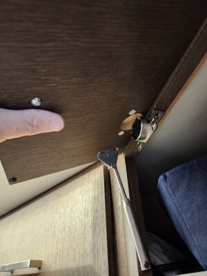

So much for solid wood cabinet doors. MDF on my 2023 Newmar New Aire cabinet doors.
Curious, what about the other doors in the coach? Did you pull any to double check if they are solid wood? Just wondering if they made that door MDF to deal with the "heat" in that cabinet
As in the OP all appear to be MDF. Here is another pic of even the tiniest of small doors above the theatre seats. You can see the mdf the holes for the hinges exposes.

I took the door off it's hinges and noticed it was MDF with wood veneer vs. being a solid door made up of multiple glued up planks.

My rig has special plastic inserts on each side of the hinges such that the screws used to to secure the hinges bites into the plastic fasteners/inserts instead of the veneer and MDF. Unfortunately, they didn't use similar to protect where the screws used to secure the struts to the cabinet doors as those go through the veneer and into the MDF.
Yeah so I went back and looked at the cabinet door. They installed the plastic sleeves for a reason, that reason being screws alone don't do well in MDF. You'd think they'd have taken similar precautions with the strut. The plastic sleeves are a good idea however.
