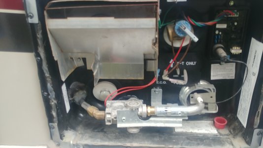

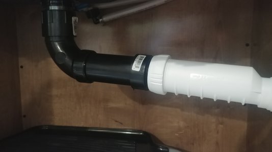

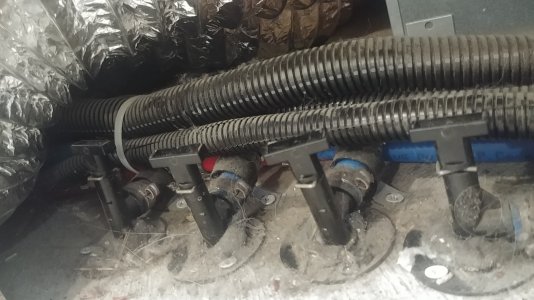

Ok. The first picture is of the 4 "low point drain valves". The second is the under sink drain. The hot water tank is behind that and the only access I can see is the outside access that is in the third photo. Does that tell you anything?

In your first picture, the low point drains you want to ope and drain. Once those are fully drained, close them again. Third picture shows the water heater and there is a white plug that you remove to drain the water out o the water heater. Underneath the water heater there may or may not be a bypass. If there is you want to bypass the water heater prior to putting anti freeze in. If you have any water filters remove those.

Thanks for your info. I figured that I needed to open the four low point drains. The manuals and videos from Coachmen are very general and while they reference both a "fresh water shutoff" and a "water heater bypass", I do not find either, maybe my model does not have them. You had asked for a picture of a "wet bay"? I do not have one. If I drain everything I can and then fill with RV anti-freeze, I am not understanding why everything references the water heater bypass and why that even needs to be turned on?
The water heater "bypass" allows you to keep the RV antifreeze out of the tank itself. Otherwise, you would need several gallons more antifreeze to fill all the lines and the tank. With the bypass, you can simply drain the water heater tank and still circulate antifreeze through the lines leading to and from it.
