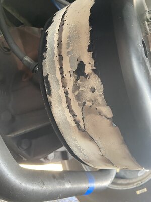

I have a 2023 Entegra Vision XL 36C that had the same leak issue at the differential mounted parking brake. The issue is related to Ford Service Shop Manual bulletin SSM51050. The bulletin describes certain motorhomes experiencing parking brake “drag”. The drag causes the parking brake drum to overheat and lock up. On one trip our parking brake got so hot it burned the paint off the drum, melted the overhead wire loom; and, damaged the pinion shaft oil seal causing the differential to loose three quarts of oil. Fortunately the oil did not come in contact with the hot brake drum. The result could have been a catastrophic fire. The fuel tank is mounted above and behind the drum.
Because of this issue, I have filed a formal fire / safety complaint with NHTSA. The complaint number is #11612346. The NHTSA Vehicle Safety Hot Line is 1-888-327-4236. Since your vehicle has already experienced a similar leak, please join me and call NHTSA.
Stay safe out there. Together we may be able get Ford to fix this Serious Safety Hazard.
