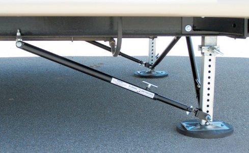

I had one, but it was only a two legged one. I didn't see where it did anything for stabilizing. I built something similar to JT's Strongarm stabilizers and that made a world of difference. The picture shows what they are.

Not sure about selling them....... I used 3/4" solid rod from an old steam boiler (commercial/industrial type) that I removed. They were what is called stay rods and 3/4" sched. 40 iron pipe plus some misc. stuff. Hard for me to get since I am full time in the RV.
