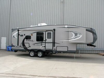

In the market for a 5th wheel, the models I'm interested in have the king pin extended out in front of the body (see picture).
Truck bed is 6.5', will I need a slider hitch to avoid contact between truck and trailer?

Yes, you will want a slider. You will get a rhythm backing it and will not need to slide it every time. When I had my fifth wheel I did not need to slide very often. It’s good to know you can when you need to. I do not know what exactly is out there on hitches today, but I would find a hitch that will wrap around the king pin. One that closes behind the king pin has too much play and likely will clank when start and stop. Good luck.
Can you provide an example of each (wrap around vs closes behind)? Are you referring to one locking jaw vs two locking jaws?
The hitch I used was a Reese it had a straight bar that closed behind the king pin. I believe one manufacturer is B&W that locks around the king pin. Eliminate the clank you will enjoy the towing.
Reese also has hitches that wrap the king pin. Invest in a quality hitch will be well worth it. My opinion.

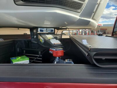

I am using an Andersen hitch with a short bed Chevrolet Duramax and do not use a slider. I can get about 75+ degrees with it. I previously had a Reese with a slider, and I never used the slider in 18 years of use. You have to pay attention, but there is not many places you can't go with 75 degrees of turning ability. Actually, if you go much more than 75 or 80 you are just sideloading the trailer tires and causing a lot of stress.
