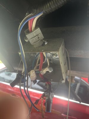

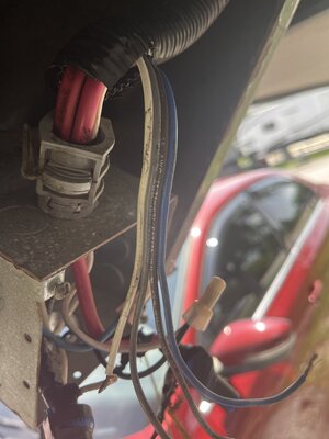

I pulled my cable out of the junction box, bought new cable but can’t find a wiring diagram, someone have a pic? 2019 chaparral 298RLS, thanks in advance

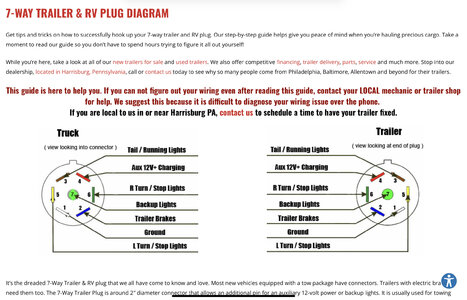

in that case, this should help
It really depends on it all being wired right in the first place
The big red wire is obviously 12v power, but I don’t see brown, green, and yellow. Looks like its going to be trial and error with a multi meter.
That is typical 4 wire flat blade. I would test each one and see what lights up. Brake/turn signal for left is one, Brake/turn signal for right is another, and marker/tail lights is another, one is a ground. The diagram provided works. Use a meter to verify the truck is indeed operating like the diagram. For testing I have a buck convertor wired to my 18v Makita batteries with an adapter to provide test current where I need it.
