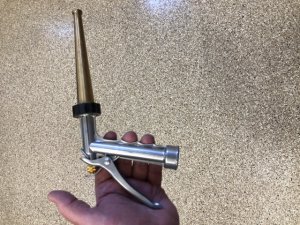

First you should clear all four drain points on the roof. It doesn’t take much debris to cover the perforated screen. Thereafter I have used this on the end of a garden hose to blow debris out. First I tried air but water works better for me. You’ll need to slide under the corner of the bus and find the duckbill (looks like it sounds) which is attached to the drain pipe. Then you can push the brass pointy gizmo up inside the duckbill until it hits the drain pipe. It may fit slightly inside the pipe. Now squeeze the duckbill tight around the brass gizmo and pull the trigger! Short blasts then release and let it drain. Of course you’ll get drenched but it’ll clean out those pesky drains. The front of the bus will have a drain on each side. The back has both sides draining to the right side of the bus. Good luck and wear eye protection!
Interesting. I hadn't thought of that approach. The short burst approach is the same as I have used with air, but may provide some lubrication to get the crud flowing down rather than blowing it out the top.
I'll have to give that approach a try.
