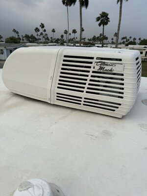

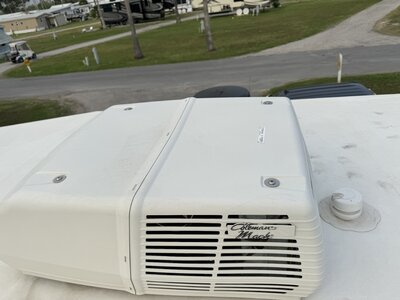

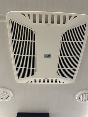

I have 2 units. We use the galley / living area unit at night. When turned on everything seems normal. Thermostat on cool fan on auto. The next morning the unit is cold and the air around is cold but no air is blowing out.
Is your coils freezing up???
This can happen if not enough air is being moved. You may need to clean the coil and filter.
