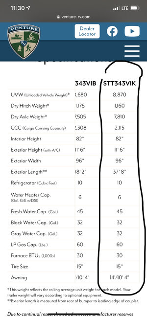

I recently purchased a new travel trailer to live in full time. I ended up purchasing a TT based on the tow capacity of my 2021 Crewmax Tundra. I did not realize I would possibly be overloaded. The dealer only recommended a stabilizer hitch since my Tundra came with a break controller(this is 100% on me for not doing the right research). The Tundra did amazing during my two hour drive home from the dealer. No sway while crossing a few longer bridges here in ENC. Also had no issues with braking. The gain was set at 3.0 for the whole trip. While spending time looking for first time RVer tips, I came across lots of threads about the current subject and determined I likely need to trade my truck now. So my question becomes, am I really unsafe when on the road with my current set up? If so, the question becomes, how much truck do I need? I will be pulling it to Florida next month, and then parking for a while. I have attached a screen shot of my TT's specs. Thank you for the help

The trailer you have listed has a GVWR of 10,985 lbs. (UVW + CCC).
That alone shows it could be loaded beyond the rated towing capabilities of the truck.
The tongue weight of that trailer loaded to it's GVWR would be about 1,318 lbs.
That is assuming 12% of trailer GVWR on the hitch.
That would only leave you 342 lbs. for EVERYTHING else in/on the truck before you hit maximum payload of 1660 lbs.
That means people, fuel, pets, kids, cargo in the bed or cab, the WD hitch (which you MUST have for that big trailer), etc.
Unless you travel alone with nothing in the truck, I don't think you can stay below that number.
